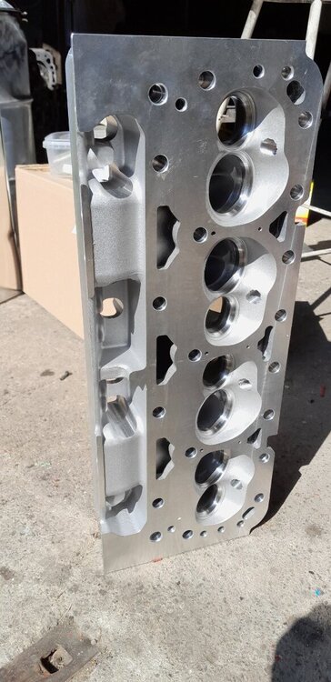

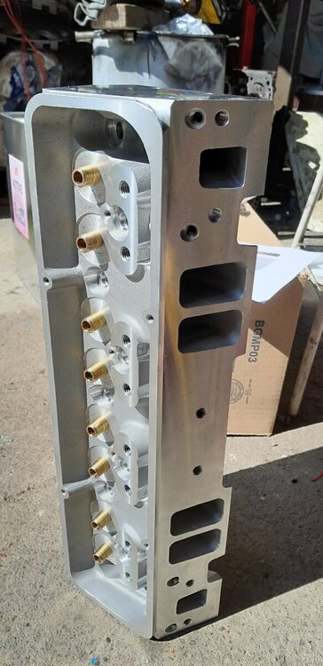

F350 Posted September 23, 2016 Posted September 23, 2016 800 euroo pari kalustettuna, mutta kenen tekemät? 185:set näyttäis virtaavan aika soppelisti tuohon mun comboon. http://jakorasia.info/aulizshop/shop/img.php?id=1464&size=l http://www.auliz.fi/shop.php Street Pro -SBC alum. heads **hi-quality street and pro –performance cylinderheads** 185cc heads flows 0.600" = 243cfm (+430hp) 200cc heads flows 0.600" = 263cfm (+540hp) -both heads exhaust flow max little under 180cfm -D -port exthaust type -Summit price same heads 1050usd -2year quarantee ! ï® Cylinder Head Material A356.0 Aluminum ï® Thick deck design, 21pound - 9,5kg each bare head ï® Combustion Chamber Volume 64cc ï® Exhaust Runner Volume 70cc ï® Intake Runner Volume 185cc or 200cc ï® Spark Plug Style Straight ï® Intake Valve Diameter (in) 2.020 in. ï® Exhaust Valve Diameter (in) 1.600 in. ï® Maximum Valve Lift (in) 0.575 in. ï® Number of Springs Per Valve Dual ï® Lock Style 7 degree ï® Valve Stem Seal Style Vition seal ï® Rocker Arm Nut Thread Size 3/8-24 in. ï® Guide plate Pushrod Size 5/16 in. ï® Valve Cover Mounting Style Perimeter bolt ï® Valve Angle 23 degree ï® Valve Guide Material Manganese bronze ï® Valve Seat Machine Style 3-angle ï® Valve Seat Material Power metallurgy ï® Steam Holes Drilled No/ If required ï® Oiling Style Through pushrod ï® 2Year Quarantee
