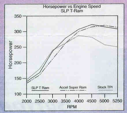

Jake Kirjoitettu 24. Helmikuuta, 2004 Kirjoitettu 24. Helmikuuta, 2004 http://thirdgen.org/techbb2/attachment.php?s=&postid=1036464 tossa on aikanaan Summitissa ollut mainoskäppyrä virtauksista. suunnilleen sumperramin luokkaa, keskialueella paremminkin. En tiiä CFM:iä, mutta näyttää lupaavalta. "The SLP T-Ram intake manifold is designed from the ground up as a high performance intake for 1989-92 Tuned Port Camaros and Firebirds. Dyno tested on a Summit Engine Shop 383 small block, it made 46 more horsepower than a stock TPI manifold at 4500 rpm and even beat out Accel's Super Ram by almost 6 horsepower 4500 rpm. The T-Ram's runners are 11.5" long for good torque production and have an "inside out" design for high volume airflow. Air flows in from the throttle body and out to the side chambers, where it is smoothly "rolled" down the intake ports and into the cylinder heads. (Your stock Tuned Port Injection crossram style manifold's runners must be kinked to clear the ports for the opposing cylinder head. That kink causes turbulence and disrupts airflow, causing power production to falter above 4500rpm) The fuel rails are cast into the manifold saving you the cost and hassle of having to purchase them separately. Its innovative design gives the T-Ram the broadest torque curve of any TPI manifold sold -- 1500-6500 rpm. And if you need proof on how good the T-Ram is, check under the hood of the 1992 Pontiac Firehawk."
